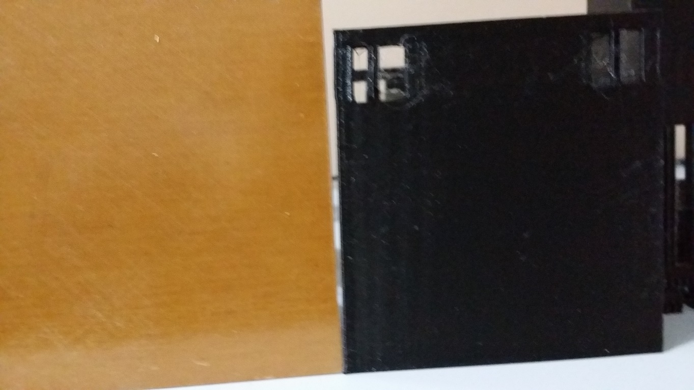

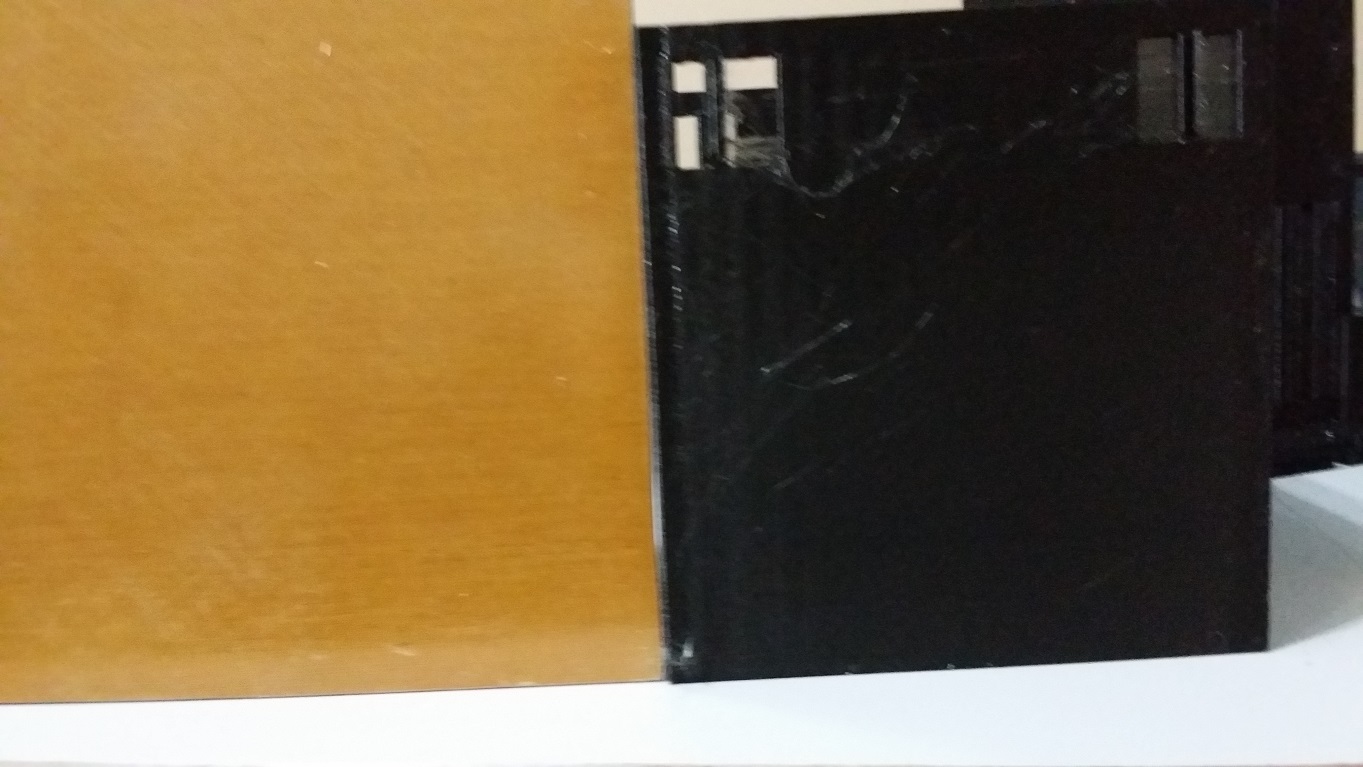

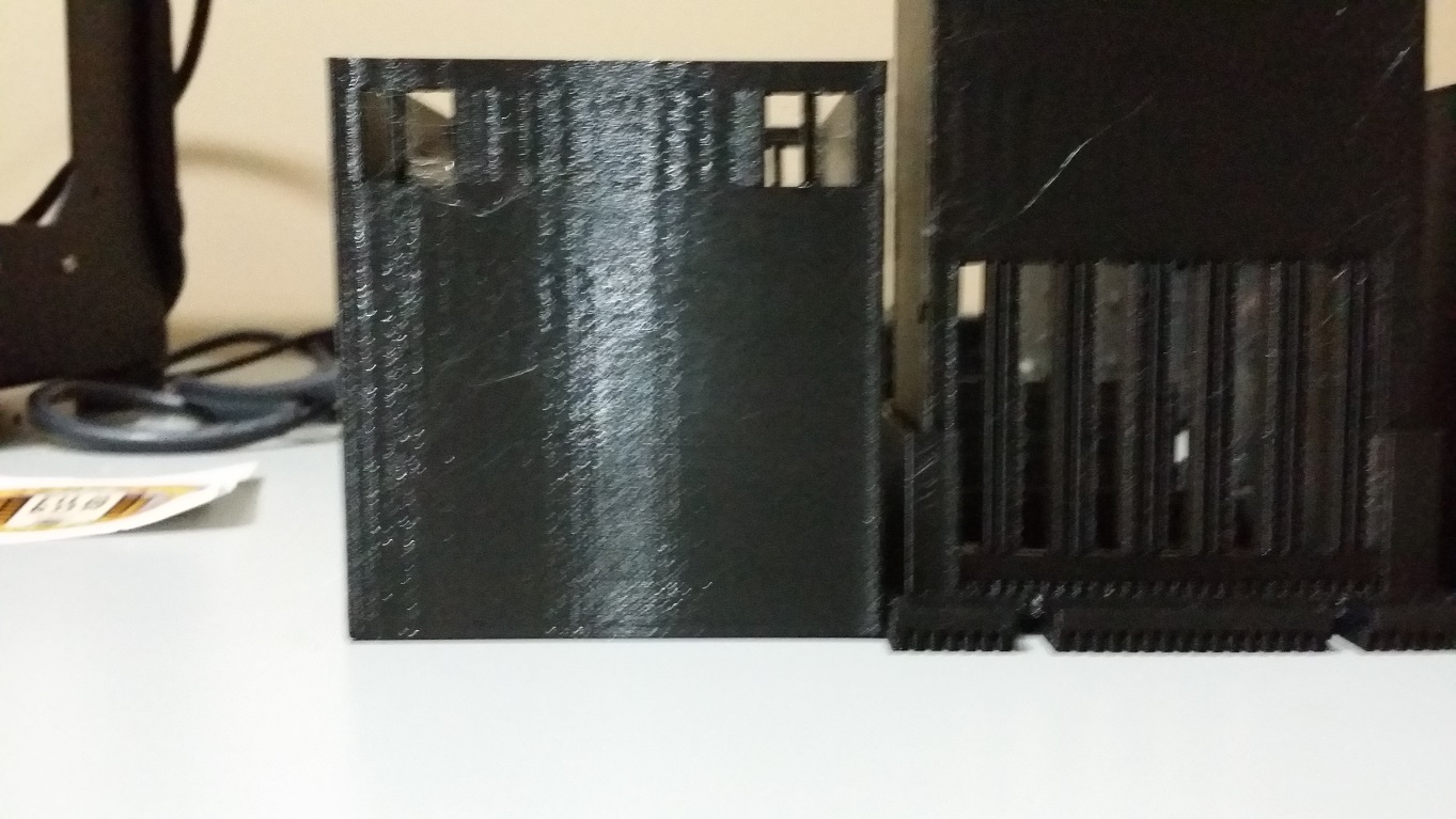

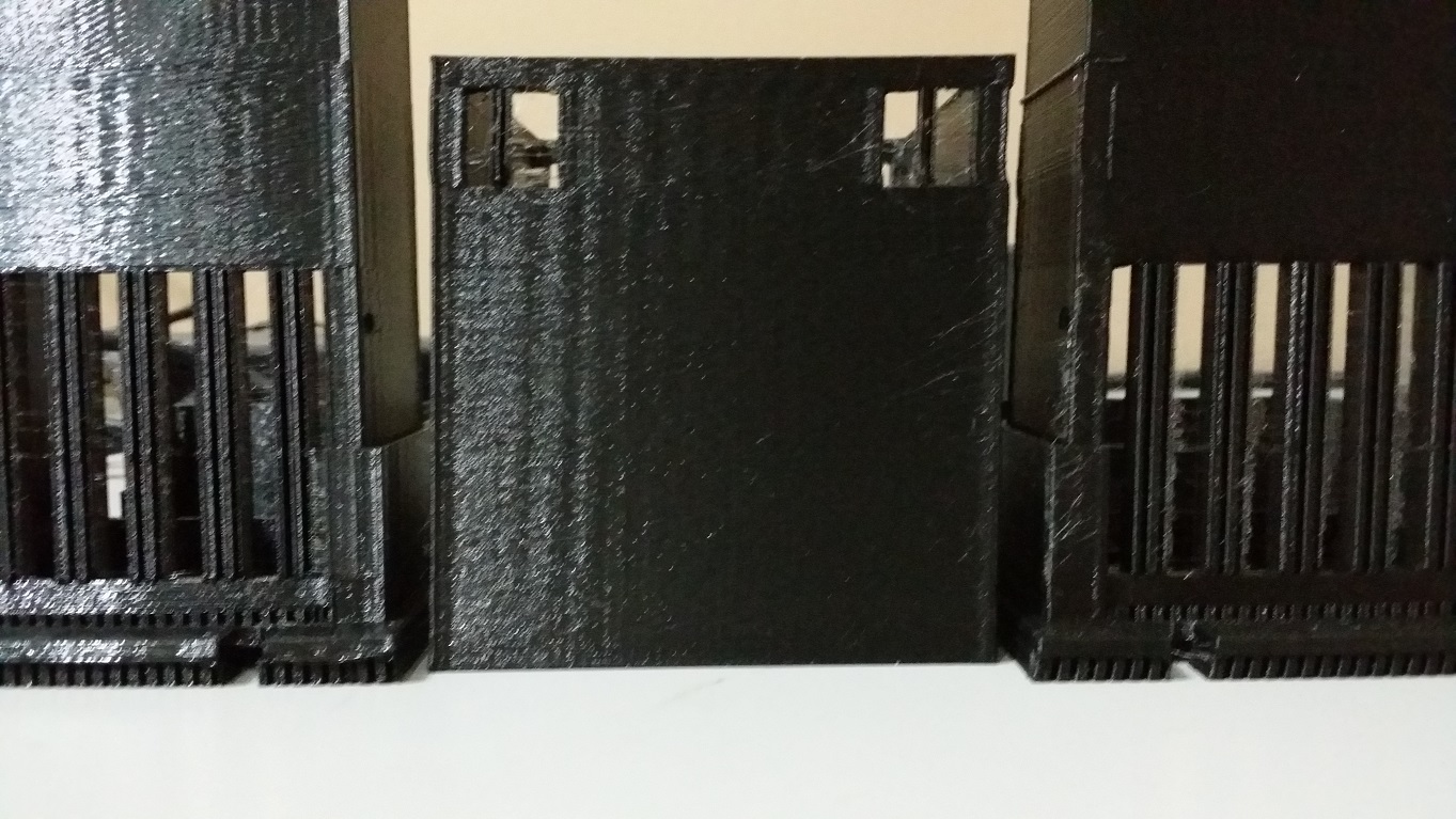

good vs. bad
Re: Y Axis Printing at an Angle
you know i cant tell how big those prints are but could it be the z rods are not set straight up and down? if those are out but the bed is leveled it will pitch your model just like that. over the 8" travel though i think there could only be enough movement to be out 1/8" or so.
