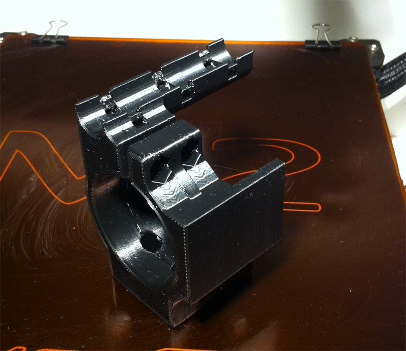

Here's the modified motor mount if anyone wants it. The bracket added to the right side keeps the motor from spinning in the clamp, so you don't have to worry about something knocking it sideways during a print. It also aligns the extruder perfectly vertical so you don't have to eyeball it.

interesting and nice mod. you were having a problem with your motor turning in the original mount with it tightened down? on all 3 machines here there is no way i could move the motor. i would need a pair of channel locks and i bet the mount would rip off the bearing before the motor would turn. i dont even have them tightened down all the way either. i did reprint mine in high infill abs but its still the stock mount. yours wasnt cracked or damaged in any way where it wouldnt hold the motor tight was it? that was a problem there for awhile.

Mine wasn't damaged, other than a crack in the cable support which seems to be prone to cracking but doesn't really cause a problem since the top piece still holds it together. My bolts just somehow worked themselves loose over time, since I know I've tightened them not too long ago. It seems strange that they could loosen given that the tension from the C clamp should have the same effect as a lock washer and prevent vibrations from causing them to work loose, but somehow it happens. With the mod it won't matter if I don't discover when they are loose now, since the motor won't be able to spin even if they are loose.
