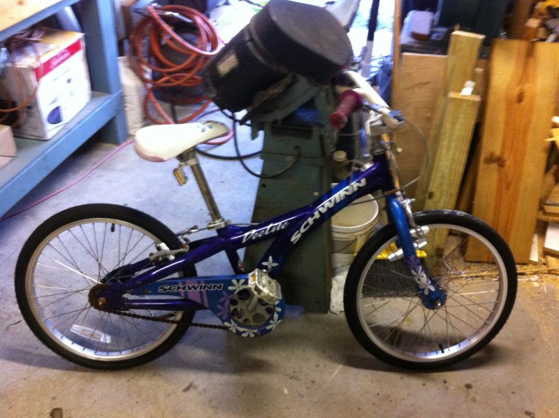

The rolling drum is by far the most common method because it mass produces them and can also be used to make color changing stars by switching to different colors while rolling. Thus only round stars can do color changes. The square stars are a European method and usually they are made by just pressing slabs of composition and then chopping them up with a long blade. That takes skill to get consistent results though, whereas anyone can get perfect square stars using the hand pump above. It is just slower than chopping them.
I've designed seven different rolling machines too. The latest one was made from a bike frame and two large stainless salad bowls seen below. I post plans for how to build these on my website at passfire.com. I try to stick with commonly available hardware store parts as much as possible and avoid requiring expensive metal working tools to make the projects more accessible.
